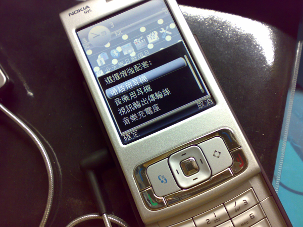

插左AD-43落部N95道, 跟住出左以下個prompt
1) 通話用耳機
2) 音樂用耳機
3) 視訊輸出傳輸線
4) 音樂充電座
揀一:
聽mp3淨係得耳筒出到聲.
用唔到線控, play/pause, fwd/bwd, vol+/-, 接電話,講電話咩都用唔到.
揀二至四:
所有線控功能一樣用唔到
有無弟兄有過咁既問題?!
究竟係機問題定線控問題呢? :roll:

philipchiu197601 寫:
Unmatch... :(
you got the same problem??
I'm just afraid that the AD-43 is defective or it is some kind of the firmware problem. :-(
any brother has same experience?

會唔會同 Firmware 有關?請問你用緊邊一個 Version 呢?

IMA Reporter 寫:
oldest one: V10.0.018

barry813902 寫:
我部机都系甘既问题啊,点会甘既呢?
我升到去V11.0.026都仲係咁, 得閒要上CS驗身. :evil:
