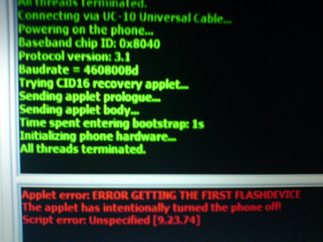

Hi i have a w800 that died while flashing because power to the cruiser cable was disconnected therefore no power so it stopped. but it happen to a 903 today but its fixed now, can anyone please help thx
DSC00097.JPG [ 103.88 KiB | 被瀏覽 1562 次 ]

it looks like hardware damage .. since even you unplg the phoneat the middle of the operation, you can always re-flash, no problem ..
but, try this:
1. Chose, 'Recovery Boot, CID 36'
2. attatch phone
3. if the program can boot the phone, then 'Replace Certificate' to 'Brown CID 36'
4. Chose' Normal Boot, any CID'
5. attatch phone, if it boots, then do whatever u was doing before

确定系 CID36 而唔系 CID49? :D 用UC-10 cable,接了3v电?

it says all threads terminated wor so that mean not fixable??
