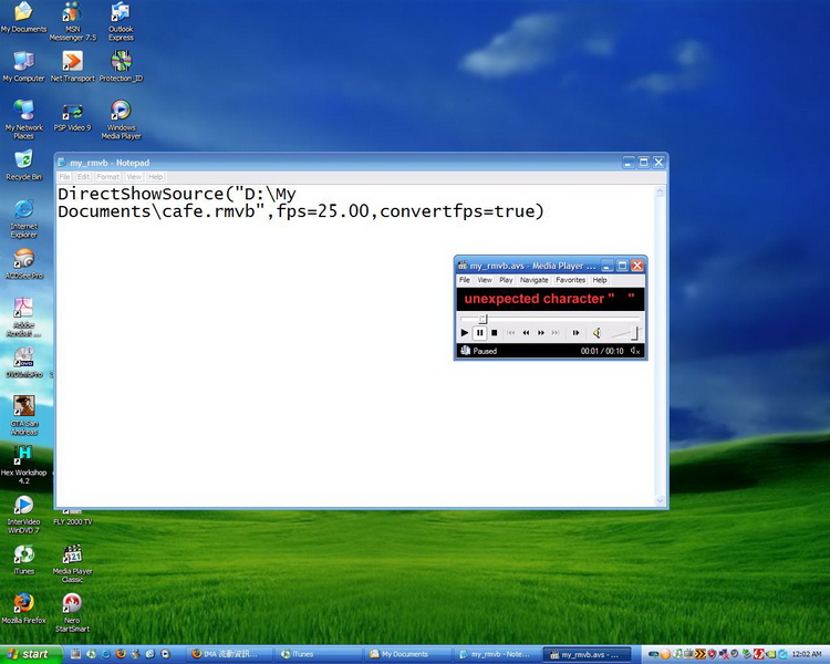

Hi,
I have tried to type in every type of RMVB file but no one seems to work. It just came out with this error massage. How should I do with it?
Many thanks!
檔案註釋: Screen
avs.JPG [ 276.86 KiB | 被瀏覽 10671 次 ]
