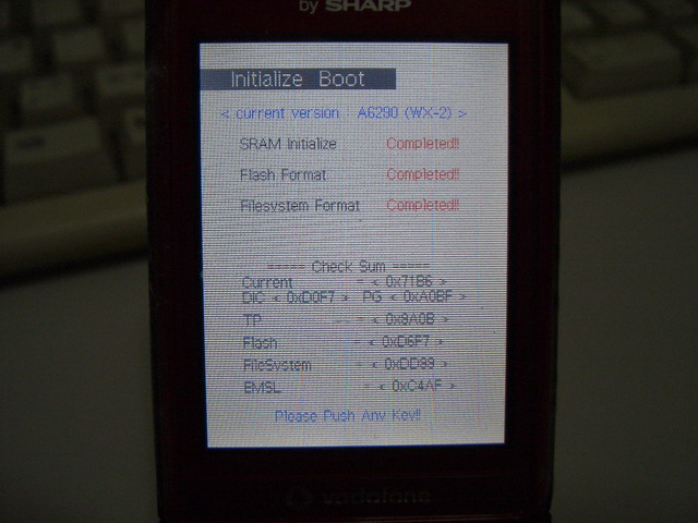

文章發表於 : 週二 2月 28, 2006 5:28 am
Last try ............. press # + power to switch on the phone. The phone will format itself. It takes 10-15 minutes.
When you see 3 red "Completed" and a blue message saying "Please press any key" than press any key to switch off the phone.
Take out the battery and reinsert it again, and now switch on the phone to test.
Good luck!
